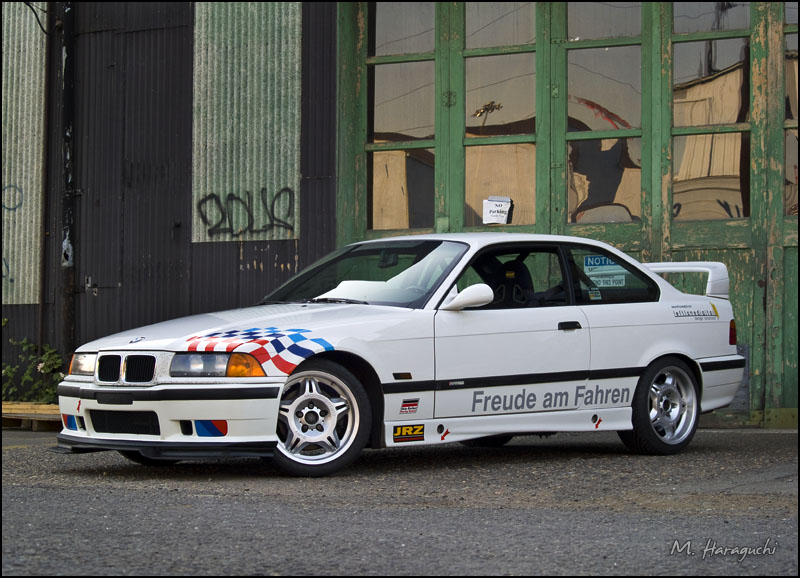

To answer a few comments:
Funny Wing
The rear wing is in fact a factory BMW Motorsport LTW 'R' rear wing. We could have gone with an aftermarket part but we decided to keep with the 'spirit' of the class which is to use original parts as would be found on these cars. BMW offered the e36 LTW street cars with this wing with two options of extension blocks to raise the height of the wing. We are using the Race height extensions like on the blue car below vs. the street extensions like on the white car below. Both cars are factory built.
Funny Number Color
The color is as one person mentioned it is the same color as the light blue in the 'M' logo. We are using the factory 'M-Motorsport' flags on the car which are slightly modified replacing the red with silver since we have a red car. We wanted the silver color but none of the vinyl companies that make numbers had the color so that left purple or the blue and we thought the blue would be more fun anyway!
Car not meeting the rules
The car is 100% legal for the ST class, in fact we are unable to get the car light enough for the class and need to remove more weight. We have been fully inspected and both our engine and transmission are sealed by Promotor. Further we are unable to take advantage of the AEM fuel injection allowed by the rules because AEM does not support BMW, so we are only able to use the original fuel injection at a further disadvantage.
