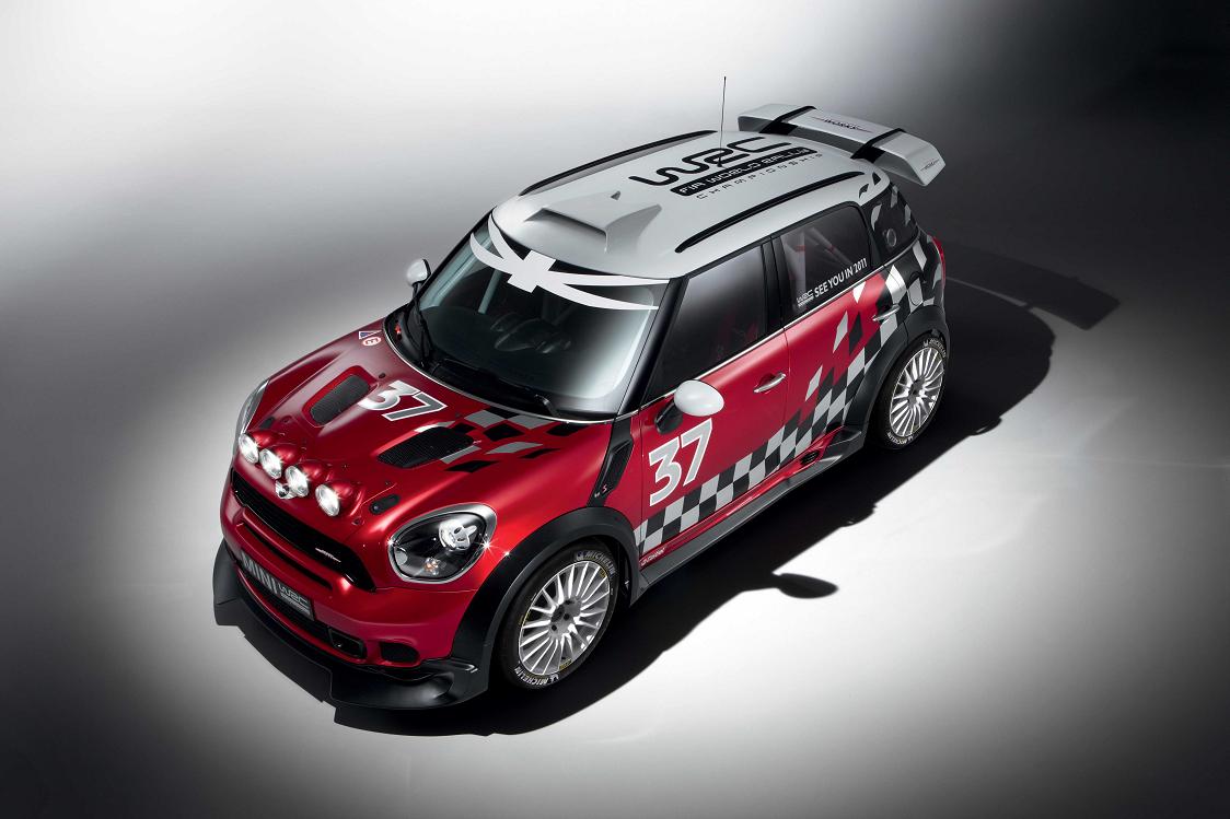

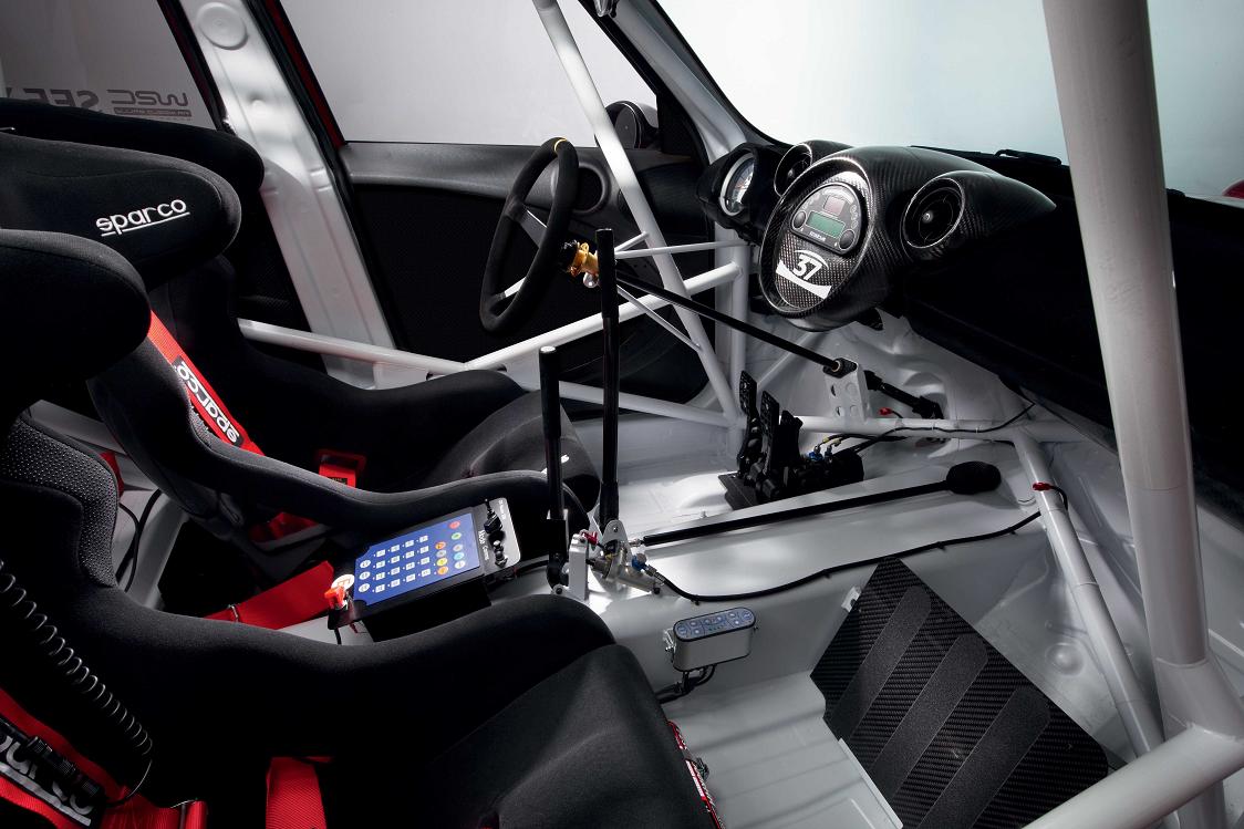

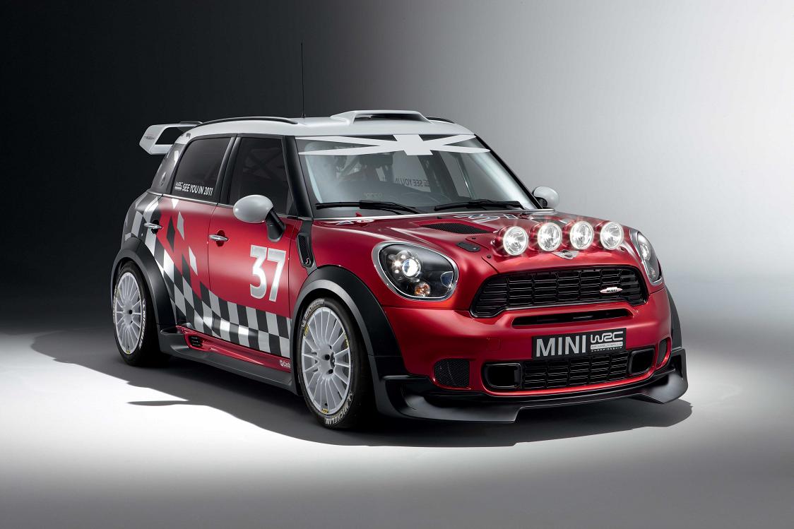

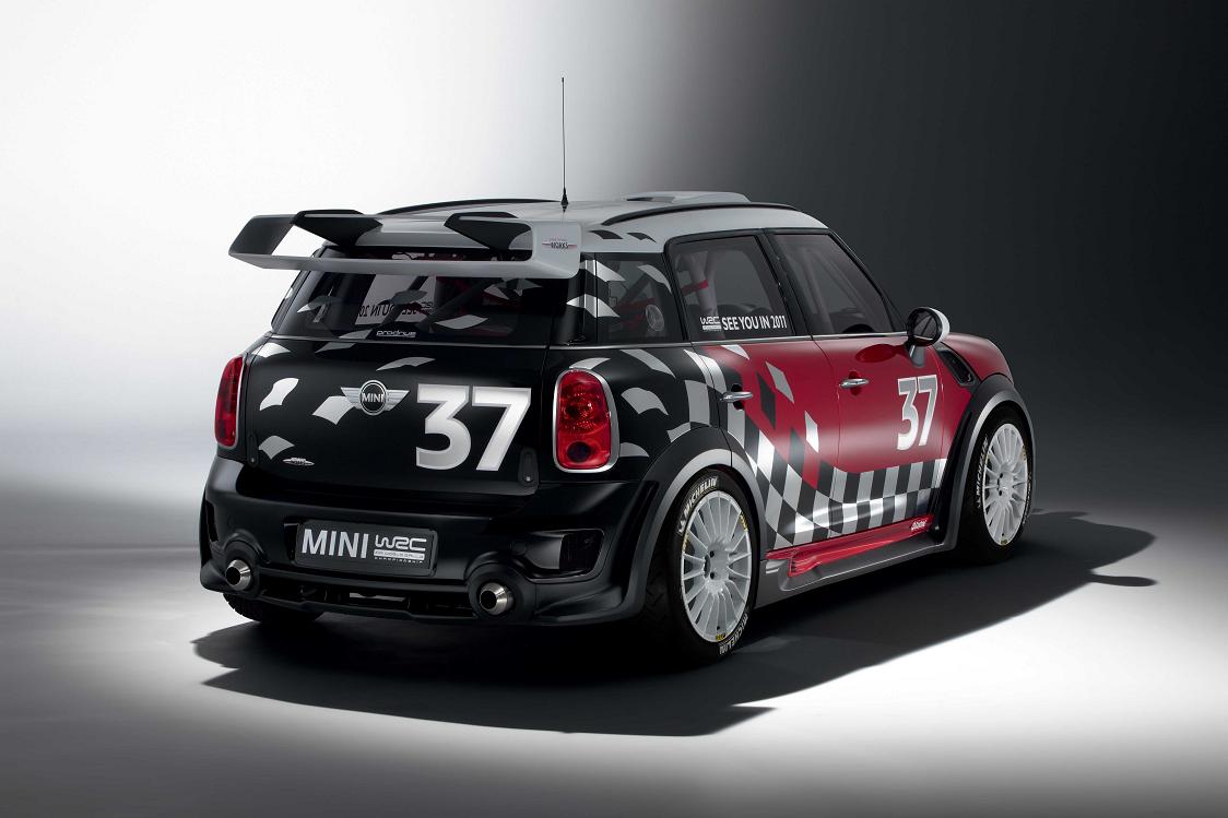

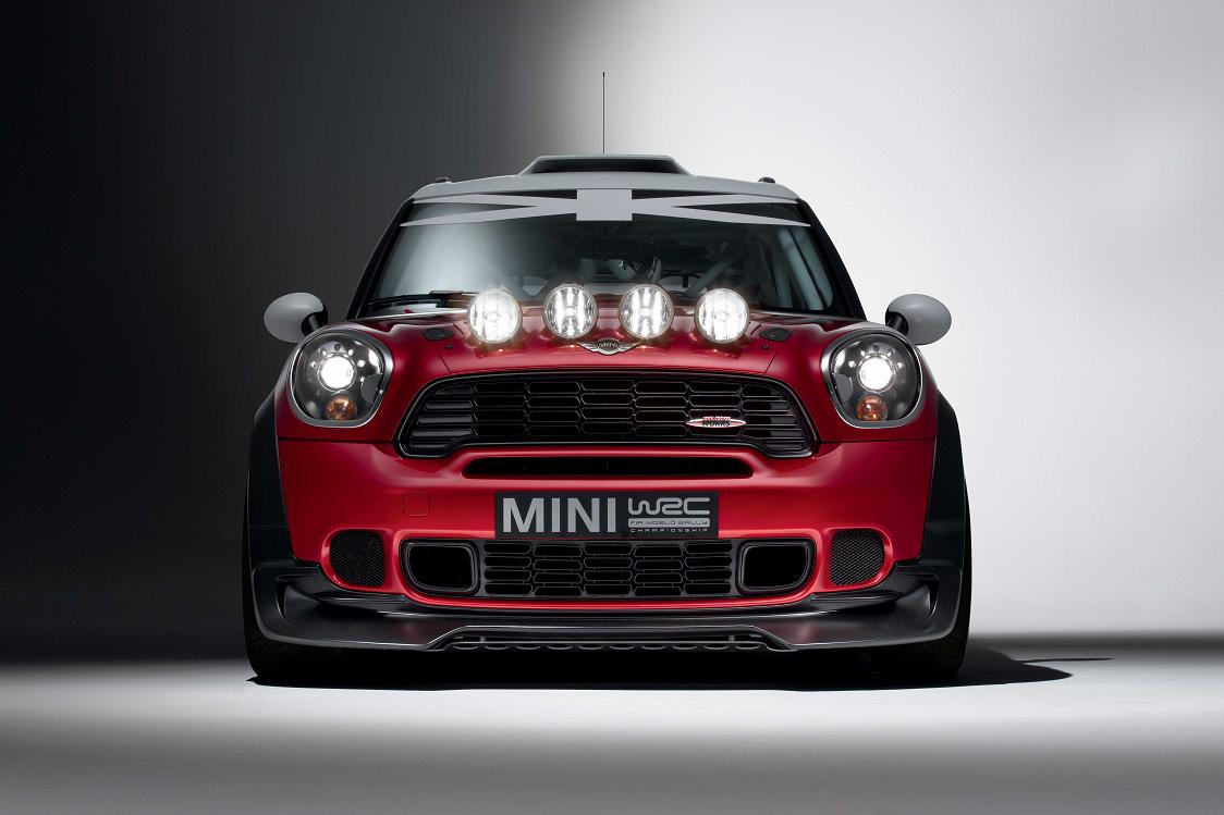

Hoy fue la presentación oficial del MINI Countryman que correrá el 2011 en el WRC
Technical specifications MINI WRC
Get to know the challenger for the FIA World Rally Championship in detail.
Dimensions:
Length: 4,110 mm
Width: 1,820 mm
Weight: 1,200 kg (FIA minimum weight)
Engine:
BMW Motorsport 1,600 cc, direct injection petrol
Garrett turbocharger - maximum boost 2.5 bar
Dry sump
Transmission:
Permanent four wheel drive
Gearbox: Xtrac 6-speed sequential
Clutch: AP Racing sintered twin plate
Front differential: Plated limited slip
Rear differential: Plated limited slip
Steering:
Hydraulic power assisted
Chassis:
MINI Countryman bodyshell with Prodrive roll cage exceeding FIA regulations
Suspension:
Front: Prodrive Öhlins Macpherson strut, 3 way adjustable damper
Rear: Prodrive Öhlins Macpherson strut, 3 way adjustable damper
Wheels:
ATS wheels and Michelin tyres
Gravel: 15” diameter
Tarmac: 18” diameter
Brakes:
AP Racing
Gravel: Front: four piston, 300 mm / Rear: four piston, 300 mm
Tarmac: Front: four piston, 355 mm / Rear: four piston, 355 mm
