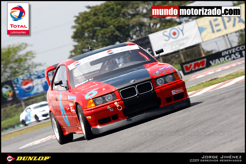

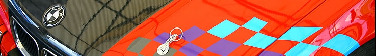

Looking forward for your post race assesment, just wanted to share a couple of pics of the E36:

Thanks for the great pics!! Race assessment posted!
